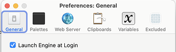

If you have Launch Engine at Login checked in preferences – the default – then you don’t need to keep the main app open except when you are creating or organizing your macros.
