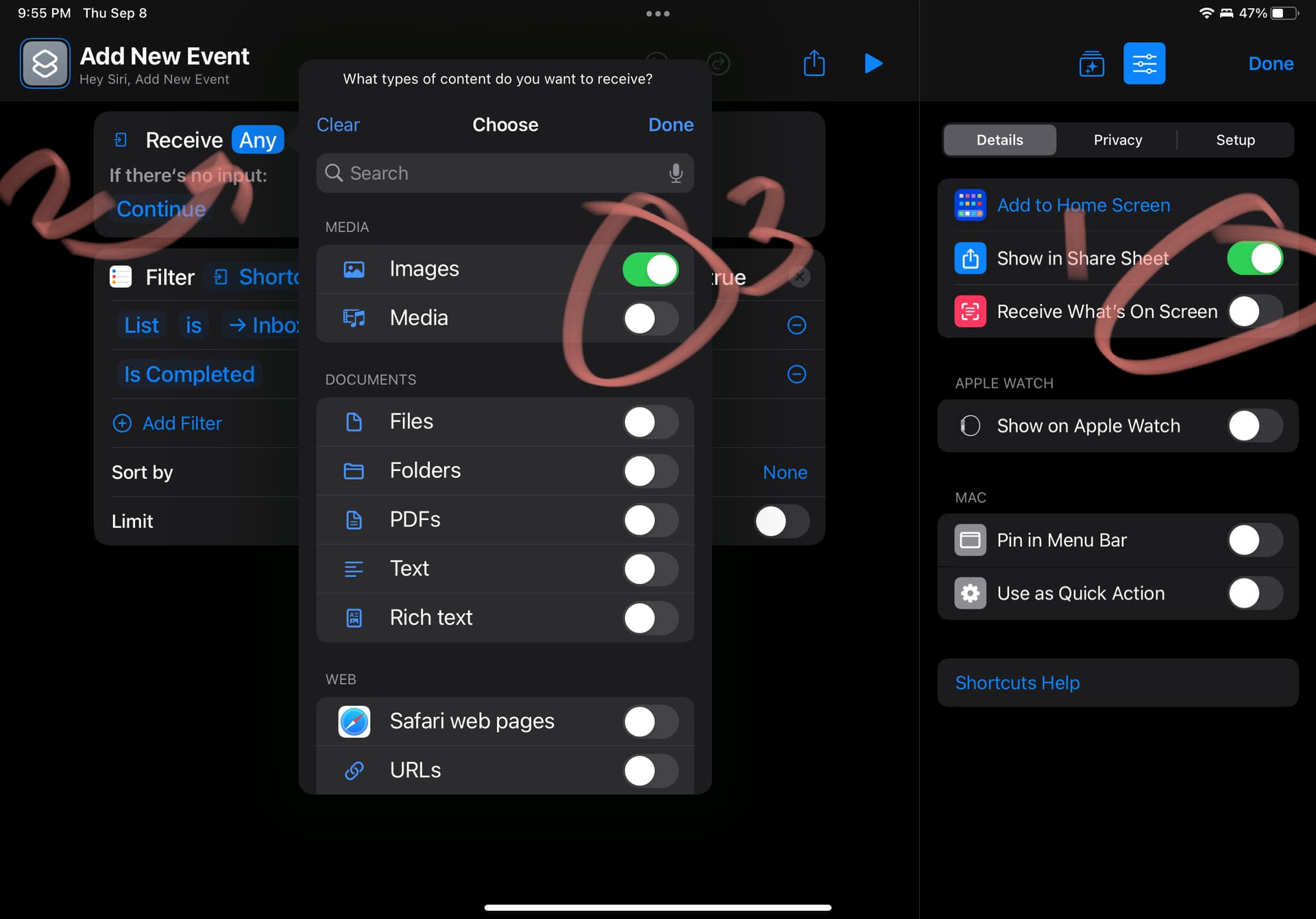

  1. If you click on the three lines slider (upper right) you get the option to Show in Share Sheet.
  2. That brings up the Receive Any… block, clicking on the “Any” allows you to narrow down the choices
  3. You don’t have to do this, but you can pick only Images.
Now this option will appear in the share sheet when you select images.
I get what you mean now. Thank you. I tried that but it disrupts my workflow as it wants me to select the photos again. I need to figure out how to avoid that. Clearly I need to get rid of the part of my shortcut that selects the photos.
