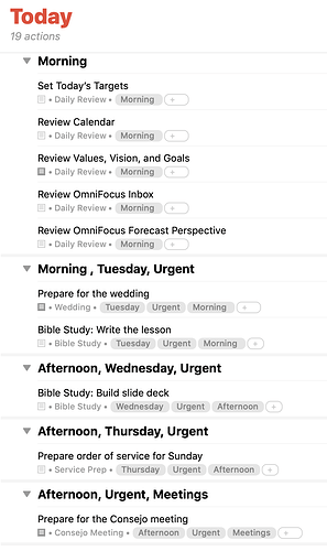

The first represents what I am trying to accomplish with one of my perspectives…to see the day separated into blocks of time. It works if each task only has one tag.
The second screen shot is what happens if you add additional tags to each task…so that those tags can be used in other custom perspectives.

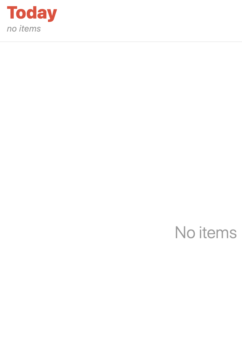

The third screen shot is what happened when I changed “any” to “all” for the tags. It resulted in “No Items”

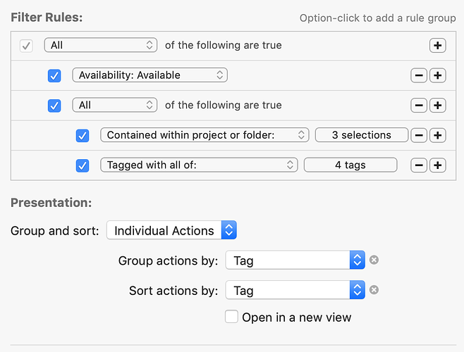

Can you screenshot the inspector view?
Great question. I have tried sorting by tags and tags/combined. I will attach the inspector view related to the screenshots.

The issue is with the sorting options. When all are in respective projects it’s easy: group by project, sort by tags. But I gather that’s not what you want to achieve…
Correct. The end result completely changes when grouped by project. The idea was to use the tags to create a really unique perspective (like the first screenshot). It is possible if you use only one tag per task. The tasks can be in any project, and they will appear in a very clean organized way…if you only have one tag per task. However, if you add multiple tags to the task, then the view becomes cluttered and more complicated (in my opinion).
