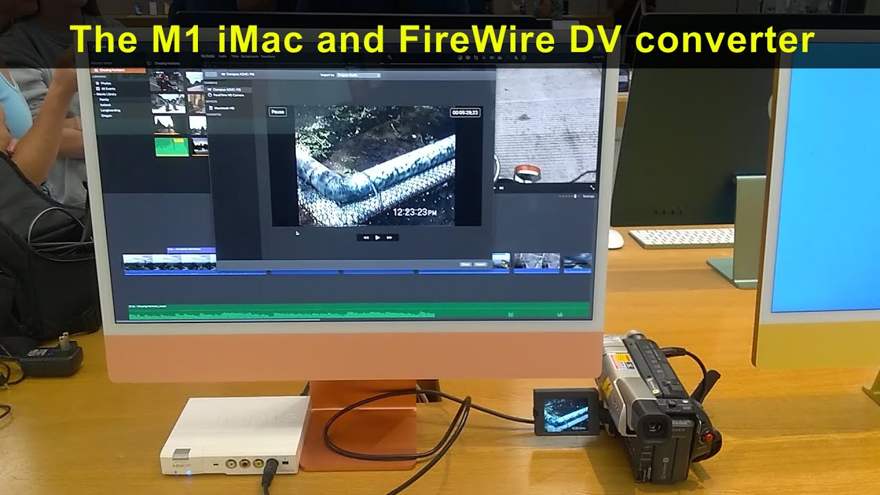

Replying to myself. There’s this:
He’s using a ADVC 110:
https://www.amazon.co.uk/Canopus-ADVC-110-Analogue-Converter-bi-directional/dp/B000GJVE8M
(around £200 on eBay!).
Wish I’d kept all that old hardware from way back when.
Any other thoughts?
