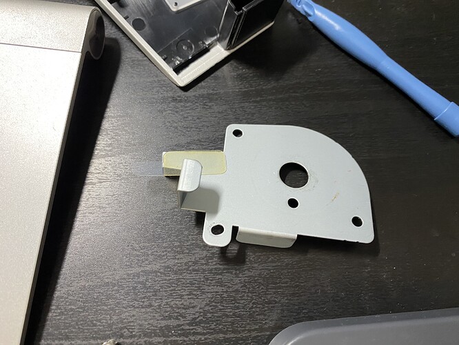

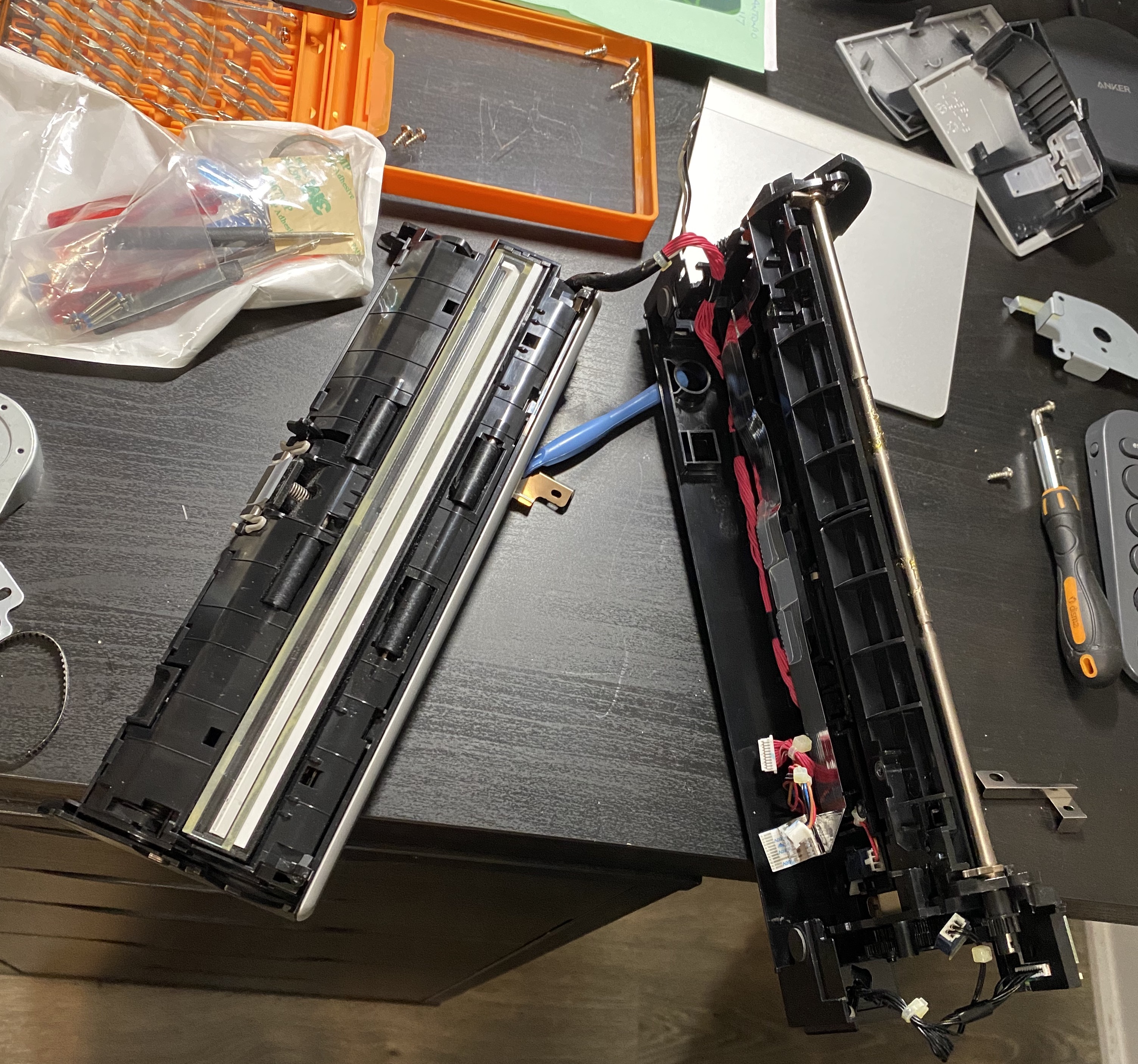

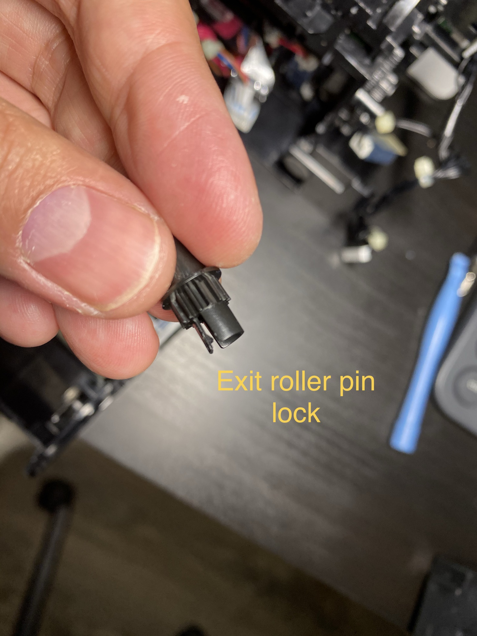

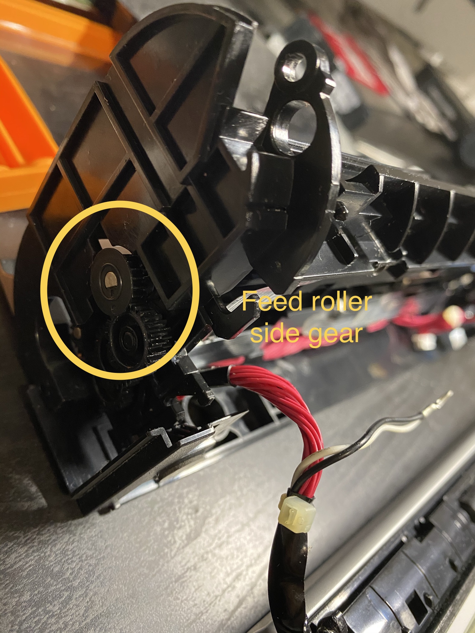

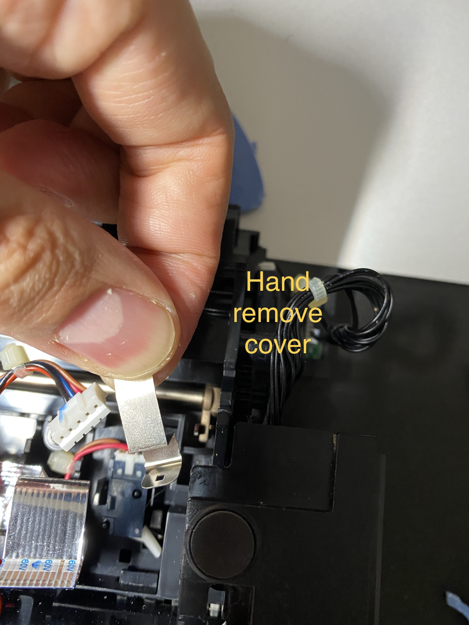

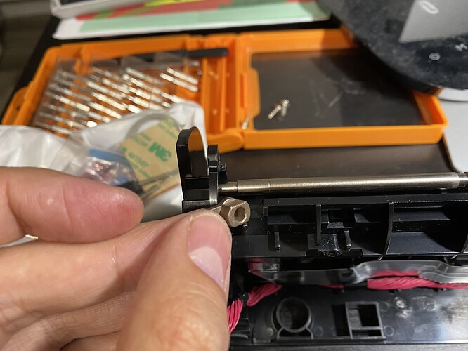

Just an update, in case somebody has the same problem:
I managed to disassemble the Scansnap and remove the 2 rollers (feed and exit). After that I ordered 2 new ones directly with Fujitsu, put them in place and reassembled everything.
It worked beautifully! It cost me a few hours but I saved a few hundred dollars. Totally worth it.
I know this last post has been awhile but could you provide some details on how you did this? For example, did you have to go from the bottom to reach the feeder rollers or were you able to do this by removing parts from the top. Any help would be appreciated!

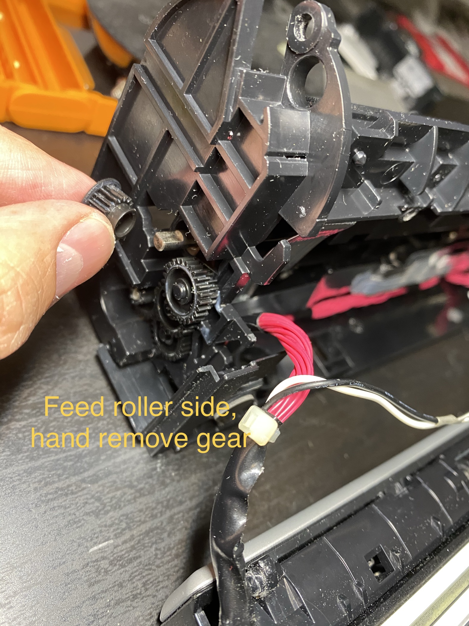

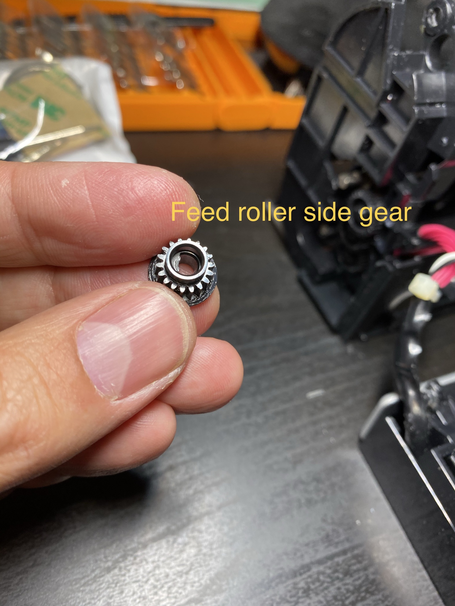

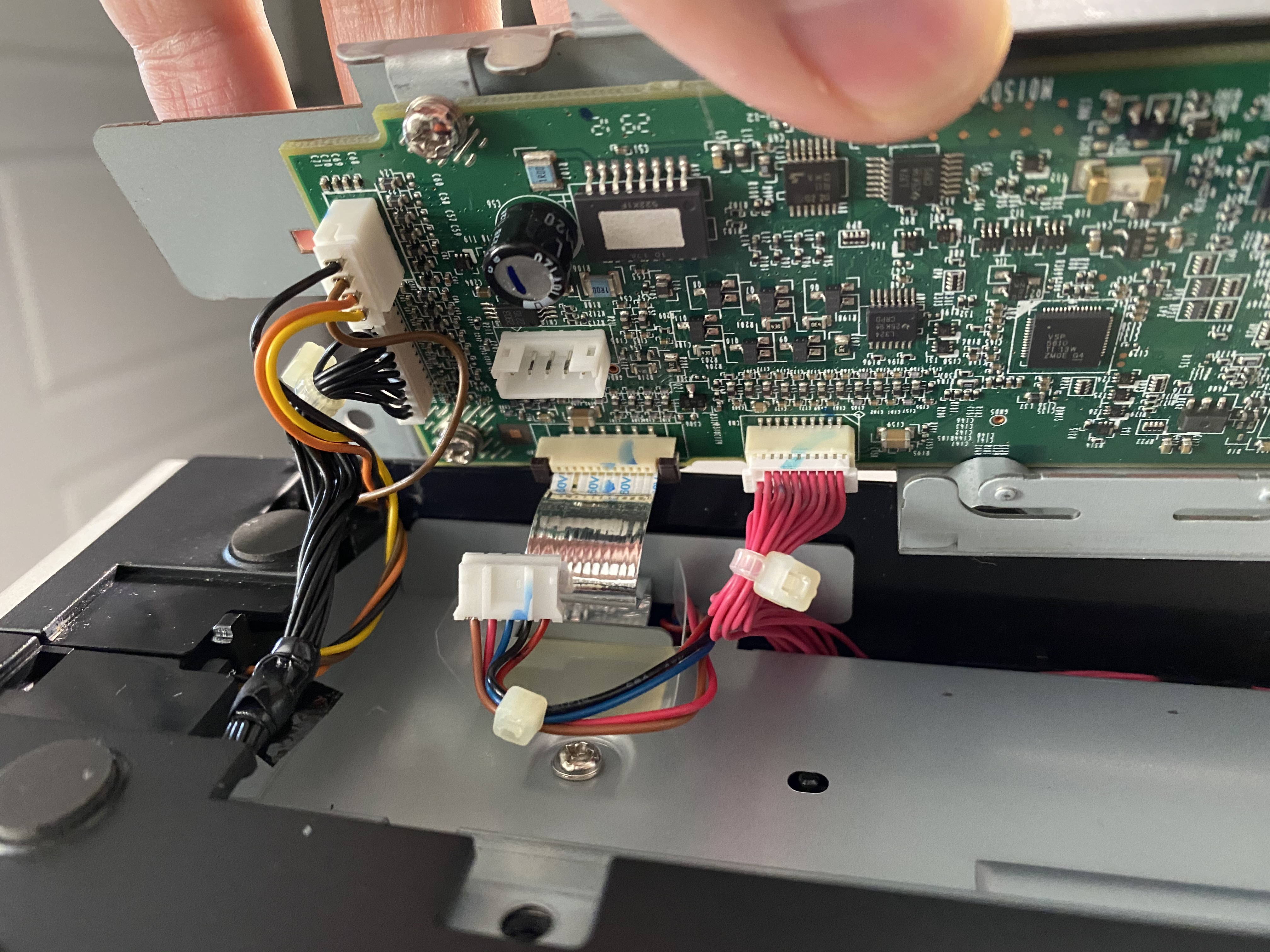

I started by removing parts from the top and worked my way down to the very bottom until I reached the feed roller and then the exit roller.
You’ll have to practically disassemble everything to replace them.

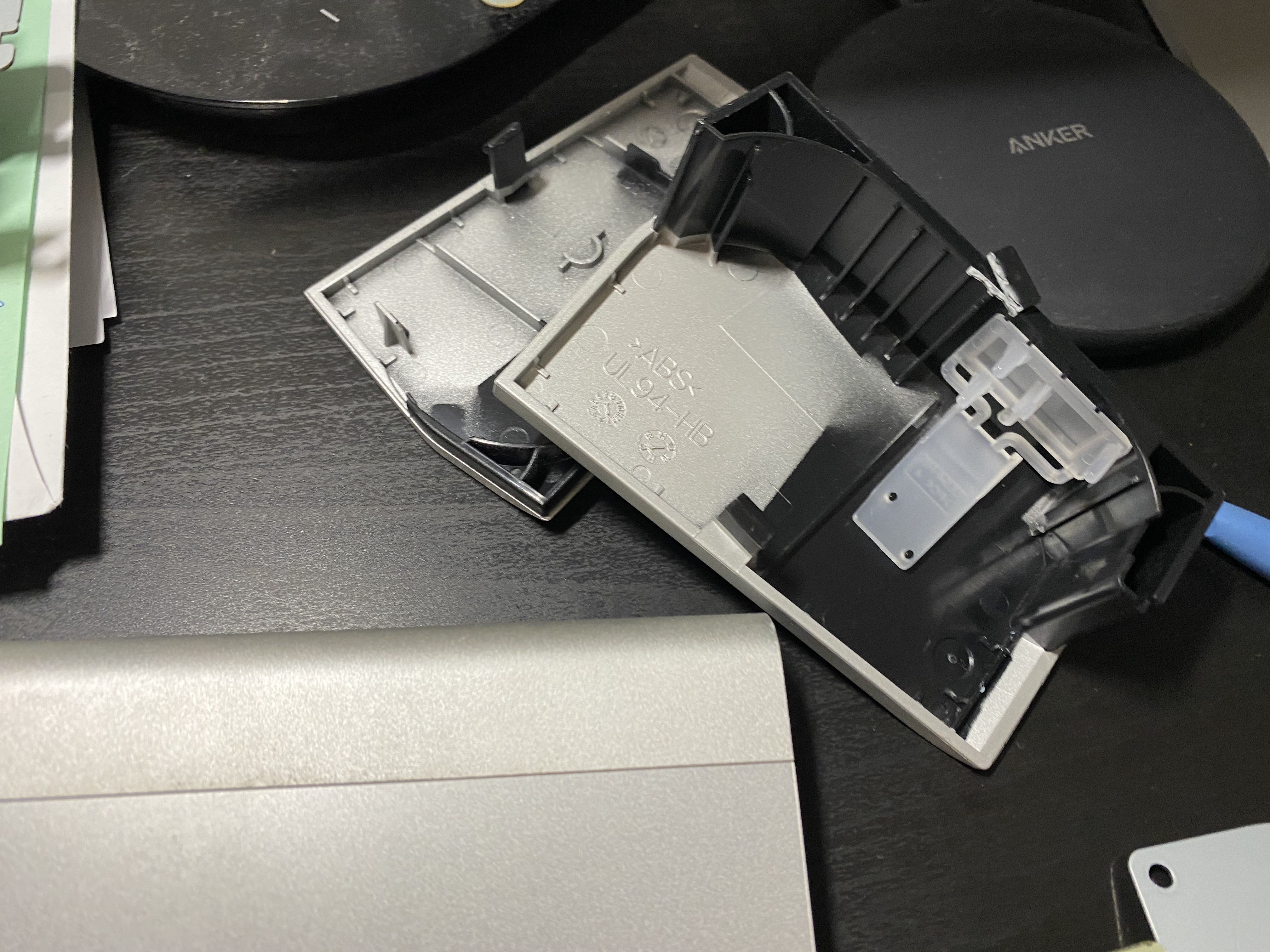

The plastic side covers were tricky to remove. I accidentally broke one of the plastic clips, so be careful.

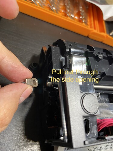

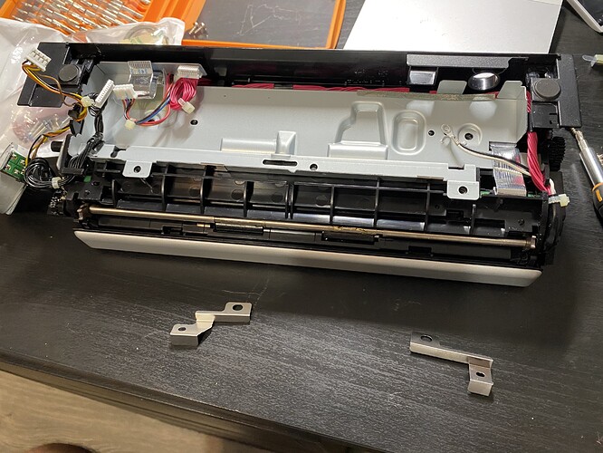

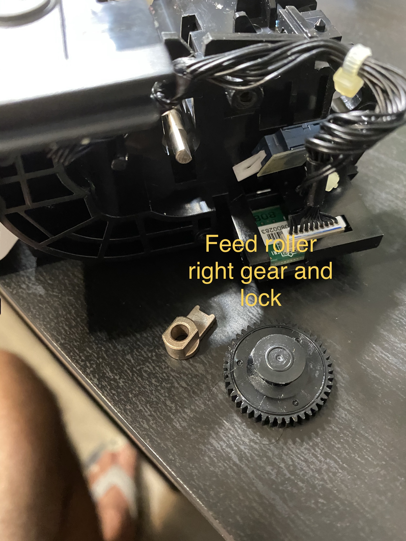

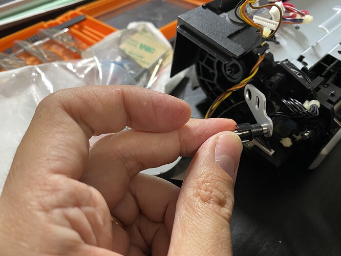

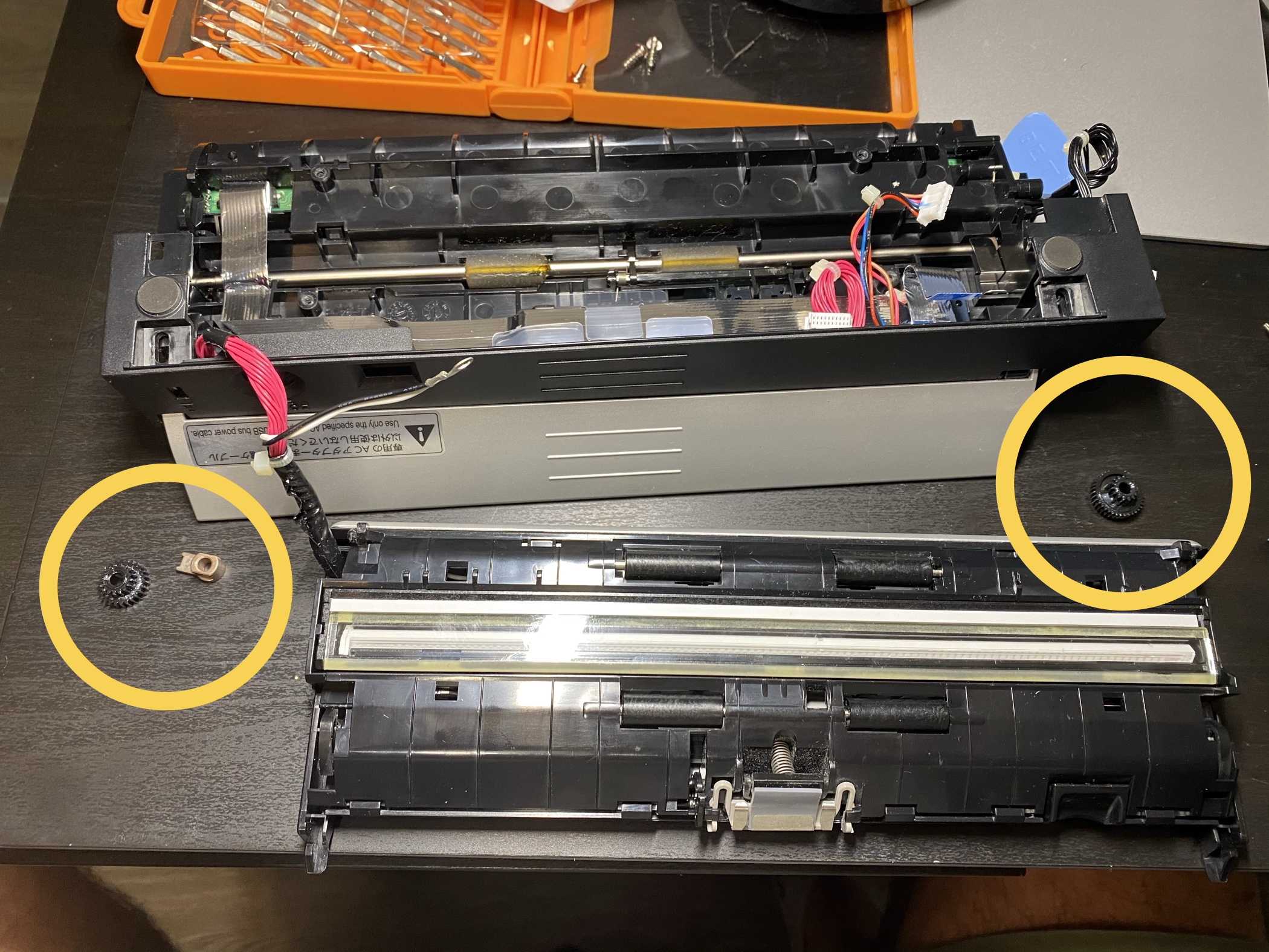

I’m attaching some pictures I took just to remind myself how to assemble everything back, while I waited for the parts to arrive. (It’s no iFixit quality by any stretch of the imagination :), and they are not properly numbered, sorry).
Hope it helps, good luck!
