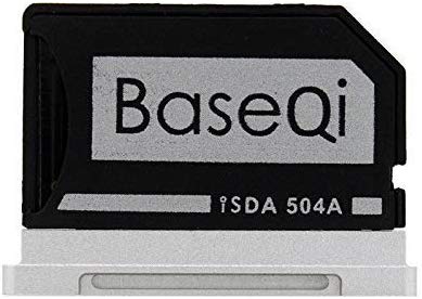

That’s the model with an SD card slot, you can get little micro SD card adapters that when inserted are flush with the side of the machine so they can remain in place all the time.
That paired with a large MicroSD card should buy you some time.

That works, except I use the SD slot. I guess I could use my USB card reader though, and drop a big microSD in there.
You wouldn’t always need to keep it in there, you could un-mount, remove it, use the SD slot for something else briefly then re-insert the “additional storage”.
To be fair, it’s not the most elegant solution, replacing the internal drive as others have suggested is probably the ideal approach for a long term solution. If you don’t like the idea of the MBP being opened up or just want to keep it ticking over till a complete new machine is viable, then this might buy you that time. The other issue with it is I doubt the speed will be that fast either. If you’re just using it for storage rather than a working area it might suffice though.
