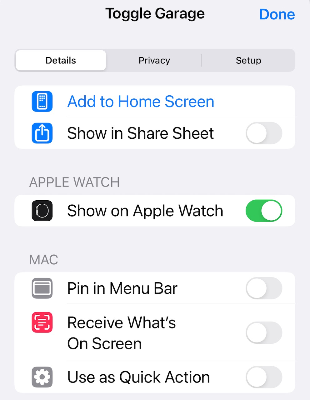

Hello, I have an iOS shortcut to toggle my garage door open or closed. I would like to be able to trigger the shortcut, via my AirPods, by saying “Hey Siri, toggle garage” while I’m returning home from a walk. Ideally my iPhone could remain locked in my pocket. Unfortunately, every time I try to do this, Siri indicates that I need to unlock my iPhone to run the shortcut.
I thought I had the shortcut set correctly to allow it to run without unlocking my iPhone (see the attached settings), but maybe I’m missing something somewhere.
In case it matters, I also wear an Apple Watch so in theory the watch and/or iPhone should know who I am and wouldn’t require re-authentication through unlocking the phone (similar to when the watch could be used to unlock the phone when wearing a mask).
I’m looking for any ideas on how to update/fix this so the shortcut runs without unlocking my iPhone. Thanks in advance!
