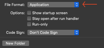

You can run the script directly in Script Editor or Script Debugger. If you decide to save this as an app, here are the steps:
1 - Once you have everything set up the way you want it, go to File > Export…
2 - In the next window, change the File Format to Application:
SCR-20251023-lrir
3 - Give it a name (I used Reminders - Backup) and that will give you this in Finder:
SCR-20251023-lsng

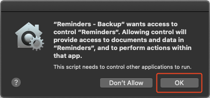

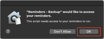

Allow Access When Saved As An App
When you first try to run it as an app, you will be presented with dialogs asking for permission. Here they are in order of appearance:
SCR-20251023-lspa
SCR-20251023-lsug

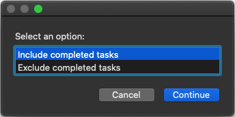

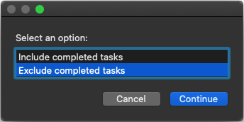

Include or Exclude completed tasks
If you set it up to show the dialog, you will see one of these, depending on what the default for completed tasks is:
SCR-20251023-lpma
SCR-20251023-lozb

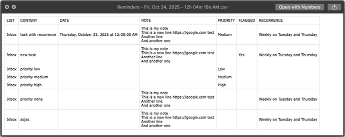

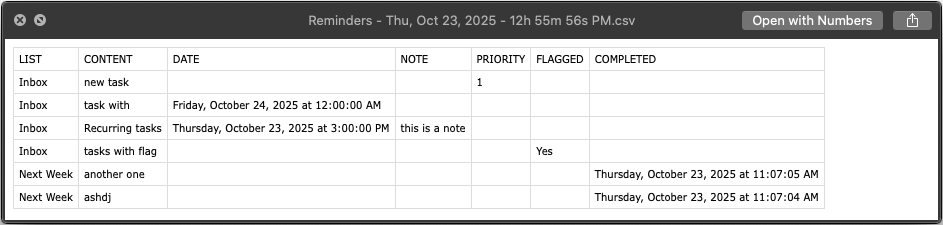

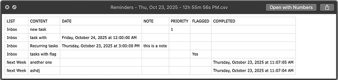

The Output
You will get a file that looks like this:
SCR-20251023-lphq
and will have the content similar to this (whether completed tasks are included or excluded):
SCR-20251023-lpfi

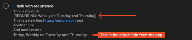

  2. Added a new “RECURRENCE” column. This requires a special “code”, but again, for those who want to use Reminders as their main app and don’t want to worry much about losing it, the extra effort is worth it, I guess.
RECURRENCE
In the Note, add a line that has the information about your recurring task. For example my test reminder’s note is:
This is my note
[RECURRING: Weekly on Tuesday and Thursday]
This is a new line https://google.com test
Another line
And another one
The rules is that it needs to follow this format: [RECURRING: YourInfoHere]
