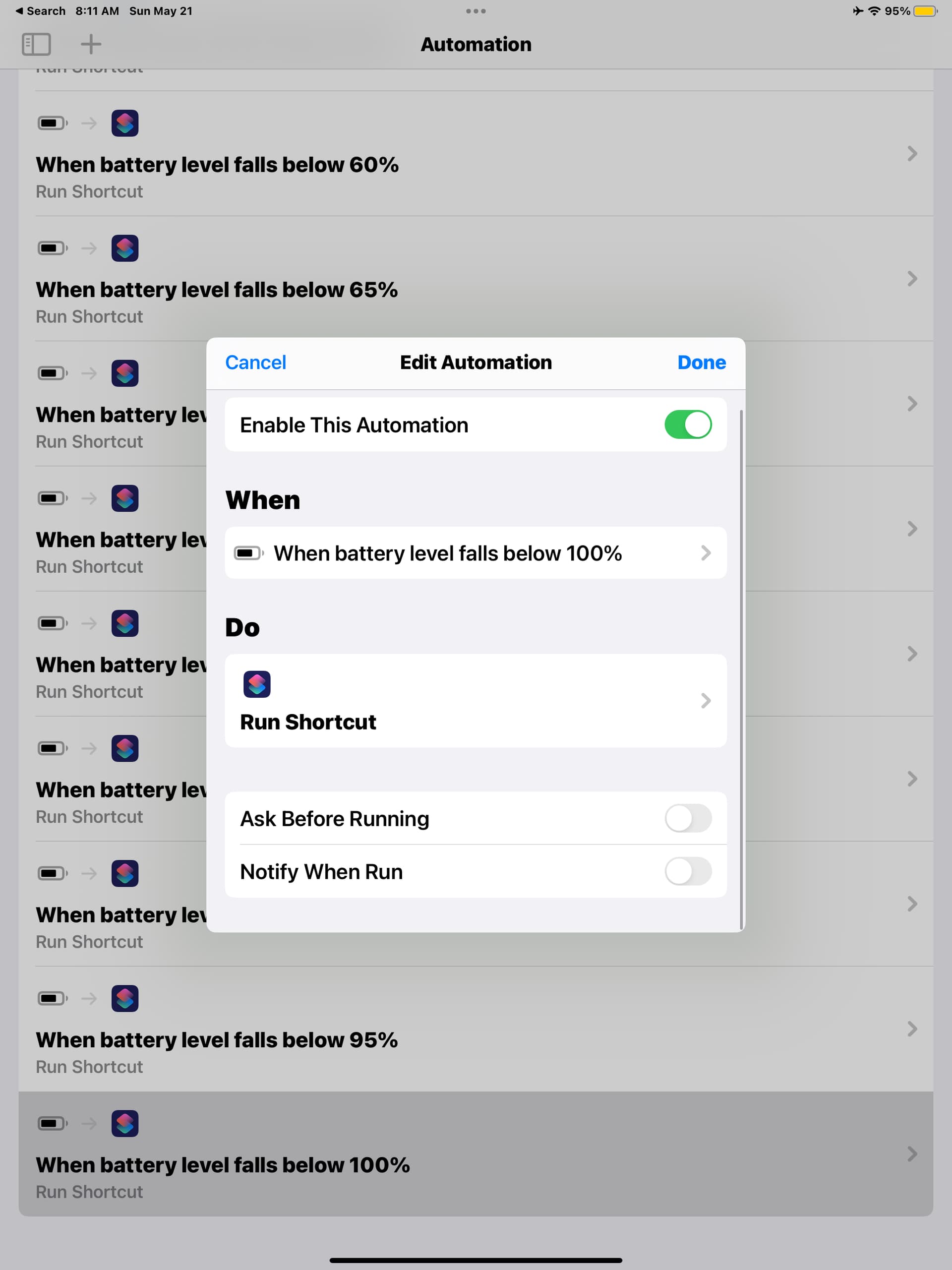

I went in and created a stack of automations. Basically, if the power drops below any given 5% mark (100%, 95%, 90%, etc. - yes, that’s 20 separate automations down to 5%) it fires off a shortcut - unattended - which sets low-power mode and turns on airplane mode.

This is the Automation screen. Like I said, about 20 different automations - one for each 5% battery level.
Each of those automations is configured like this. The “When” is whatever battery level you’re targeting, and the “Do” is always “Run Shortcut”. Make sure “Ask Before Running” is off, along with “Notify When Run”.
