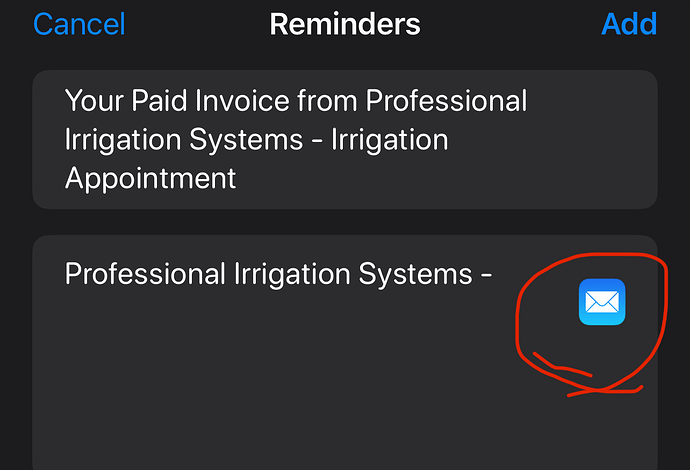

No, unfortunately, Apple has not created that feature. One can drag and drop an email to Reminders, but that is not how I do it. I select the subject line in Mail and then share to Reminders. This embeds the email in the task with the subject of the email being the task name. Below are screenshots.
