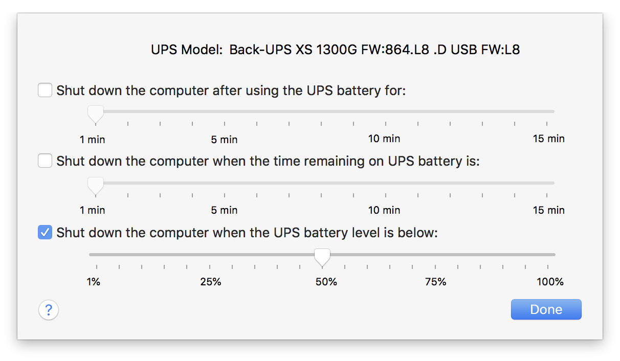

I recommend connecting your UPS to your iMac via USB. Once you do this you’ll see a UPS tab in System Preferences > Energy Saver. Using this panel you can specify display options.
2018-08-19%20(07-57-53)%20-%20Energy%20Saver
…and if you click on Shutdown Options you’ll be able to specify under what circumstances you’d like your iMac to shut down.
2018-08-19%20(08-06-20)%20-%20Monosnap
I have mine configured to shut down the computer when the battery level of the UPS drops to 50%. So, if it’s a relatively short outage my iMac will remain running. And if the power’s out for a longer period of time my iMac will shut down safely.
