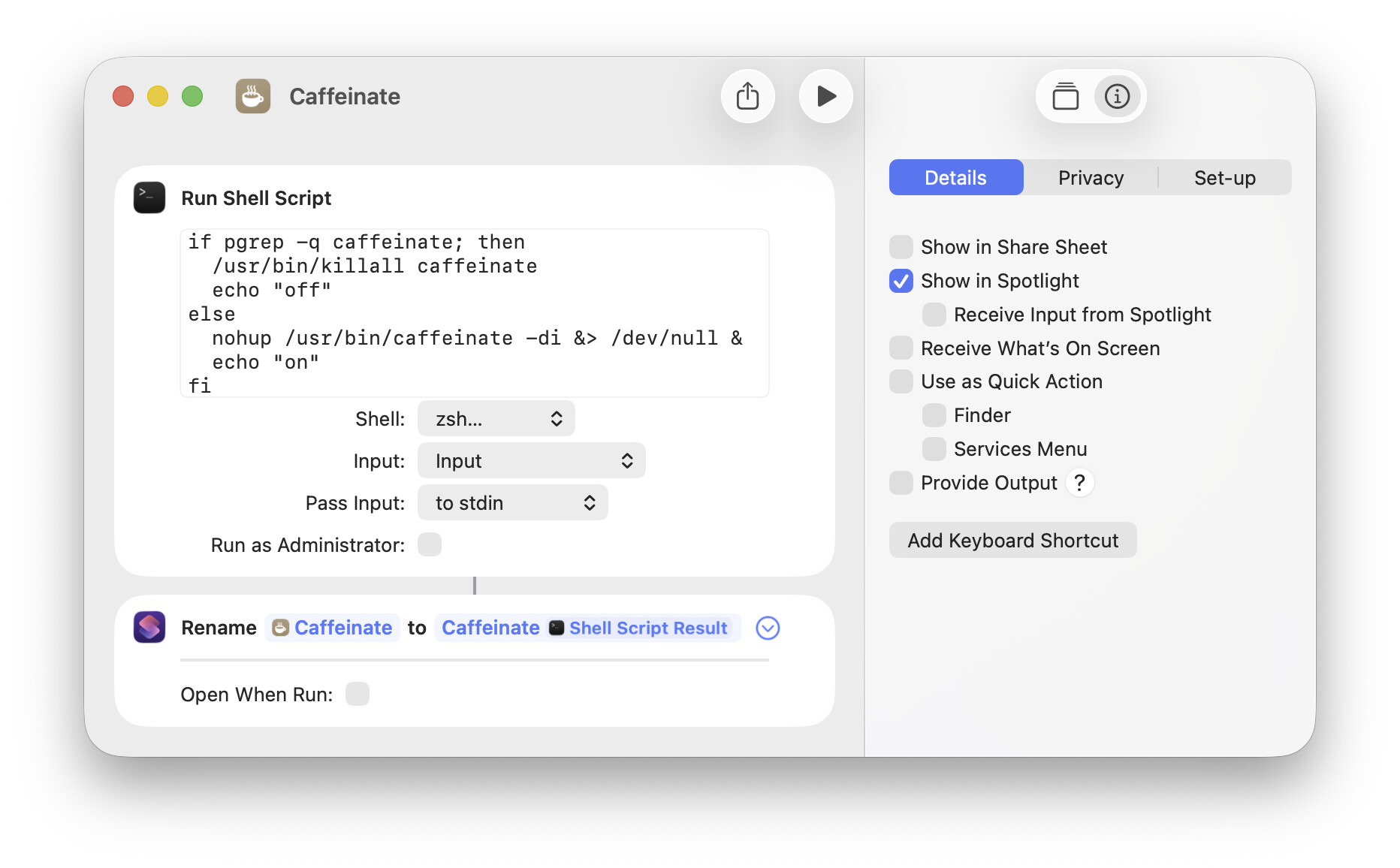

There’s numerous menubar utility apps to keep the screen on with more or less features but these controls cannot be moved into the new Control Centre. I figured it ought to be to possible to do this with the built-in caffeinate command and without third party utilities since Shortcut controls are supported. The only issue was, while a shortcut that toggles a setting or running process is easy enough to create, it is hard to tell the current state of the setting or process. The key was using the Rename Shortcut action so the shortcut can rename itself when it is run so that the title shown in the Control Centre widget updates with the current state.

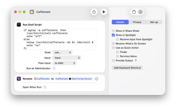

The shortcut only has two actions. A shell script checks to see if caffeinate is running - if it is, stop it, otherwise start it in the background to prevent system sleep:
if pgrep -q caffeinate; then
  /usr/bin/killall caffeinate
  echo "off"
else
  nohup /usr/bin/caffeinate -di &> /dev/null &
  echo "on"
fi
In each case, the status is output and passed to the next action which renames the shortcut with the status (be sure to disable Open When Run).
