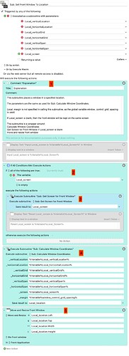

OK, here is a bunch of stuff that will explain how I position windows. There are a bunch of macros, all but one are utility subroutines that are used by my other window placement macros. I have written out an explanation. I’m sure there are plenty of other ways to do this, but this is what I put together. You might want to download this screenshots and view in Preview where you can make them much bigger to see what is going on. I don’t know if there is a way to enbiggen them here, so apologies on that.
As I wrote up the notes I found a few bugs. Things that do not affect the way that I use the windows, but in some of the parameter checks, which won’t work exactly as they should. Since I am careful with the parameters I feed into these macros I haven’t had any issues, but I will shortly fix this stuff up.
I can upload a macro library if anyone is interested, but this may be more overhead than most people need or want. I also want to modify my subroutines, because they all assume they are working with the frontmost window of the frontmost app, and KM does provide a way to handle other windows, which I have not yet played with. I might modify my subs to handle that as well and default to the front window/front app if no window is specified, to make them more general.

B) Subroutine “Set Front Window To Location” is used to position the frontmost window.
  1. It takes a bunch of arguments, specifically the vertical and horizontal location for the window, the vertical and horizontal grid size, vertical and horizontal span values, and a screen to position on. The logic is that the screen is considered to be divided into a grid of m rows by n columns with each row and each column of equal size. A window’s location is the box on that grid where the top left corner of the window is placed. A window can span 1 or more columns and rows. This is just like how Moom does it when you set up custom windows, except that with Moom you set the rows and columns and that applies to every window template, while here you can call this subroutine with different values any time you use it. Thus, if you make the verticalgrid and horizontal grid 5 x 5, set vertical and horizontal location both to 2, and both spans at 3, you would get a 3 x 3 box window with 1 box around all of the margins. (I hope that makes sense). That way, to make a window that is full screen in height at the right 2/3 of the screen, I set the grid to be vertical 3, horizontal 1 (1 row x 3 cols), make the location vertical 1 horizontal 2 (there is only one vertical or row in the grid, but start with the top left of the second column) and set the horizontal span to 2 to span 2 columns, each of which is 1/3 the screen width).
    Also: I have another subroutine which takes these parameters as a single argument which is a JSON dictionary which is more convenient when calling these macros outside of KM such as in a kmtrigger: URL callback. That subroutine just unpacks the dictionary and calls this macro.
  2. If a screen was not specified, assume the front window will stay on its current screen. The sub “Get Screen for Front Window” figures out where the front window is.
  3. I pass the arguments over to a sub which calculates the proper coordinates on the proper screen to put the window and return that location. Note the use of one additional variable, “window_control_grid_spacing”. This is a KM global variable that specifies, in pixels, the size of a margin to put around the window when fitting into the grid. I like to have my windows not quite touching, so I generally set this to 1 or 2.
  4. Move the window to the calculated location.
