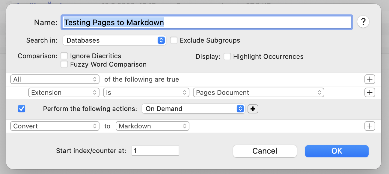

I tried to set up a smart rule but it doesn’t work as I’m expecting. Is the problem that DT cannot convert Pages docs?
Correct, DT does not convert Pages docs. I’m hoping a script can be added that can.
