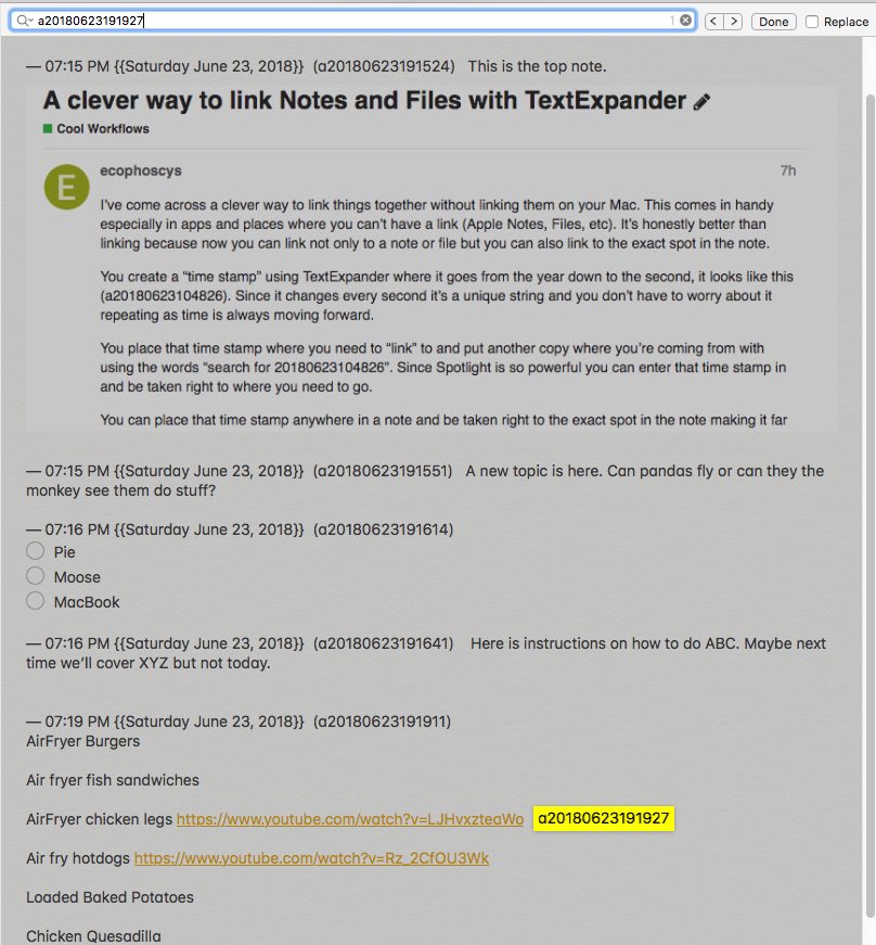

You place that time stamp where you need to “link” to and put another copy where you’re coming from with using the words “search for 20180623104826”. Since Spotlight is so powerful you can enter that time stamp in and be taken right to where you need to go.
You can place that time stamp anywhere in a note and be taken right to the exact spot in the note making it far superior to linking. Maybe you’re writing up a case and you need to refer back to a certain spot in some other note that is buried, with this method you can search for the note and not only that but cmd+f the time stamp and go right to the location in the note.
You may have noticed I left out the “a” in the time stamp where I’m coming from. That is so that I don’t get the places I’m coming from showing up when searching. I could have many places I’m coming from and I don’t need them showing up.

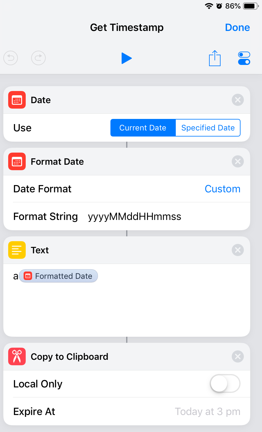

To make the time stamp I have two keys I use, the + and the - keys since they’re right next to each other. You can make your triggers anything you want in TextExpander. Here is the exact snippet I use in TextExpander - (a%Y%m%d%H%M%S)
