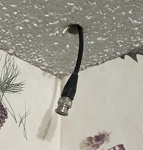

10BASE2 which worked fine from dialup through DSL but not particularly fast just on the LAN. The wiring is (as seen here) still in place! I feel it pays to be as futuristic as possible since upgrading can be a lot of work.
;-). Hoping that Cat6 cable is futureproof for at least 10 yrs. If we still own the house at time it will be interesting to see if there is any benefit to wires then.
