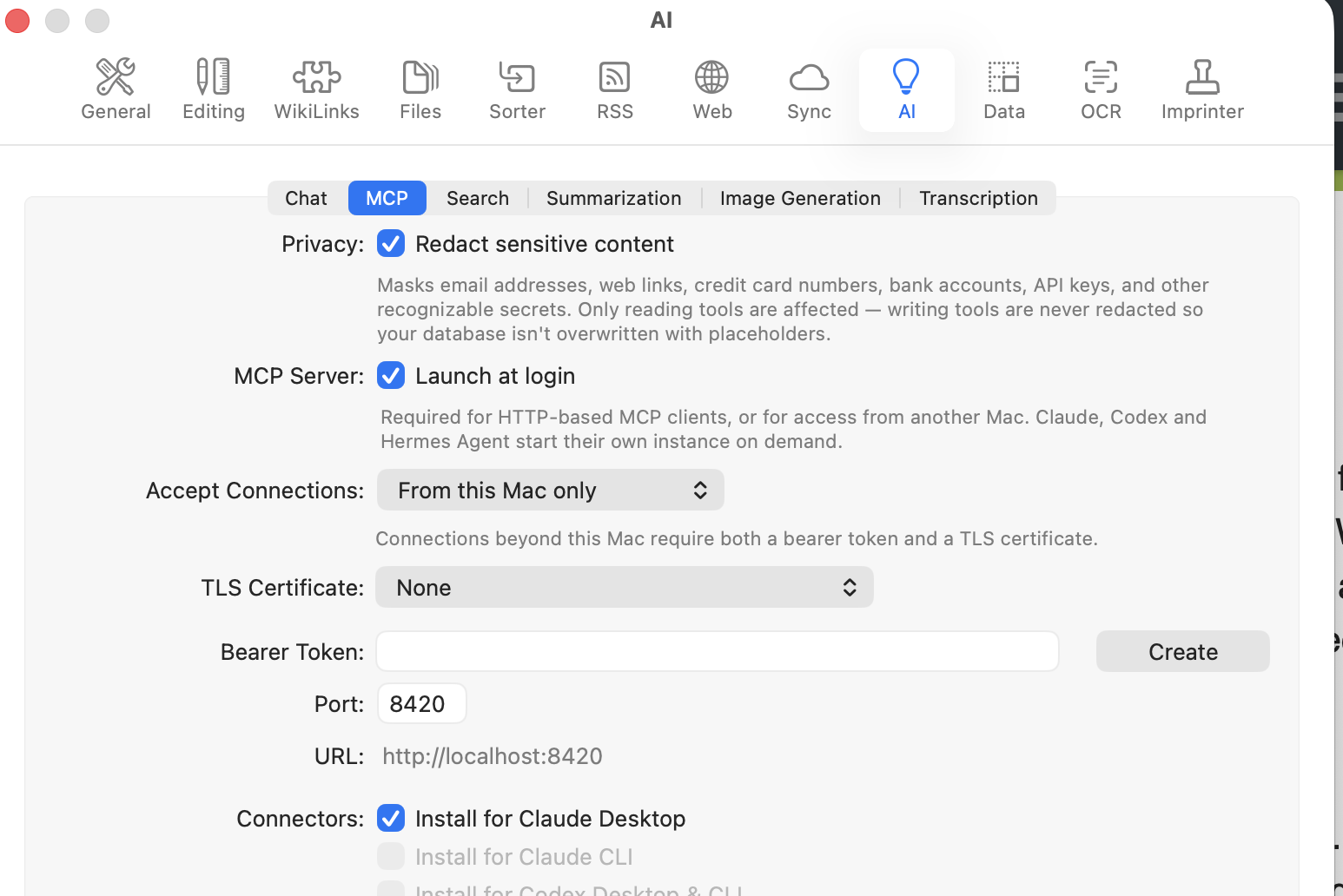

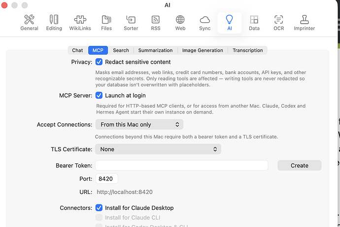

The connection gives Claude direct access to my DEVONthink databases. From an ordinary Claude conversation, I can ask it to search my records, read a document, pull together my highlights and annotations, find documents related to one I am studying, or summarize a folder of research. Claude sends those requests to DEVONthink on my Mac, receives the results, and works with them in the conversation.
Two points deserve emphasis. First, my documents remain where they have always been. Nothing is uploaded wholesale, nothing is moved, and my database structure is untouched. Claude retrieves only what a given request requires. Second, I do not construct search syntax or export files for analysis. I ask in plain English, and the assistant does the searching and the assembling.

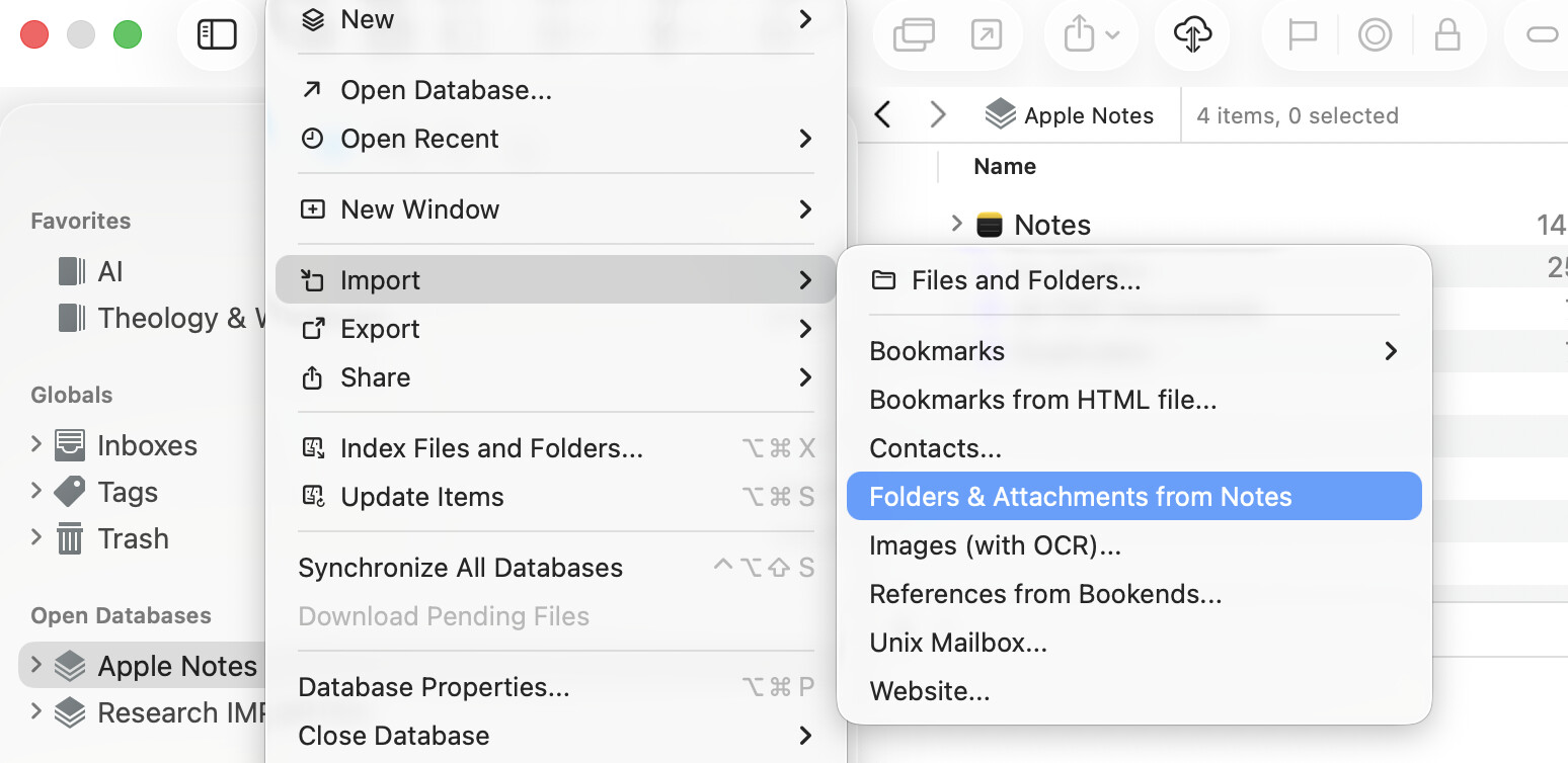

Yes, that is precisely how I use DT. Although I keep all research material and my Kindle highlights in DT, I keep all my personal reference material (career and household stuff) in Apple Notes. Once every six months or so, I import my Apple Notes into an Apple Notes archive database in DT.

There is no specific issue with indexed documents and Claude with DEVONthink’s MCP server.

Some further detail: the Cowork progress indicators show tool calls like “get_databases,” “search_records,” and “get_record_text” with a “D” icon next to them. It’s my understanding that the “D” indicates that the source was DEVONthink. If I open the “Result” capsule under “search_records,” it shows the following:
Request
“query”: “Salgado”,
“database_uuid”: “BB9BF456-FE43-40BF-8193-C2E79F43AC39”
Response
{“count”:9,“results”:[{“databaseUUID”:“BB9BF456-FE43-40BF-8193-C2E79F43AC39”,“uuid”:“2A635D69-5AA8-415A-B6DD-9E172593988A”, … etc …
This looks like Claude is searching the DB to me, but I’m new at this …
In any event, unless you open up the progress indicators for the detail, whatever is going on is unobtrusive.
