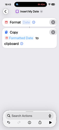

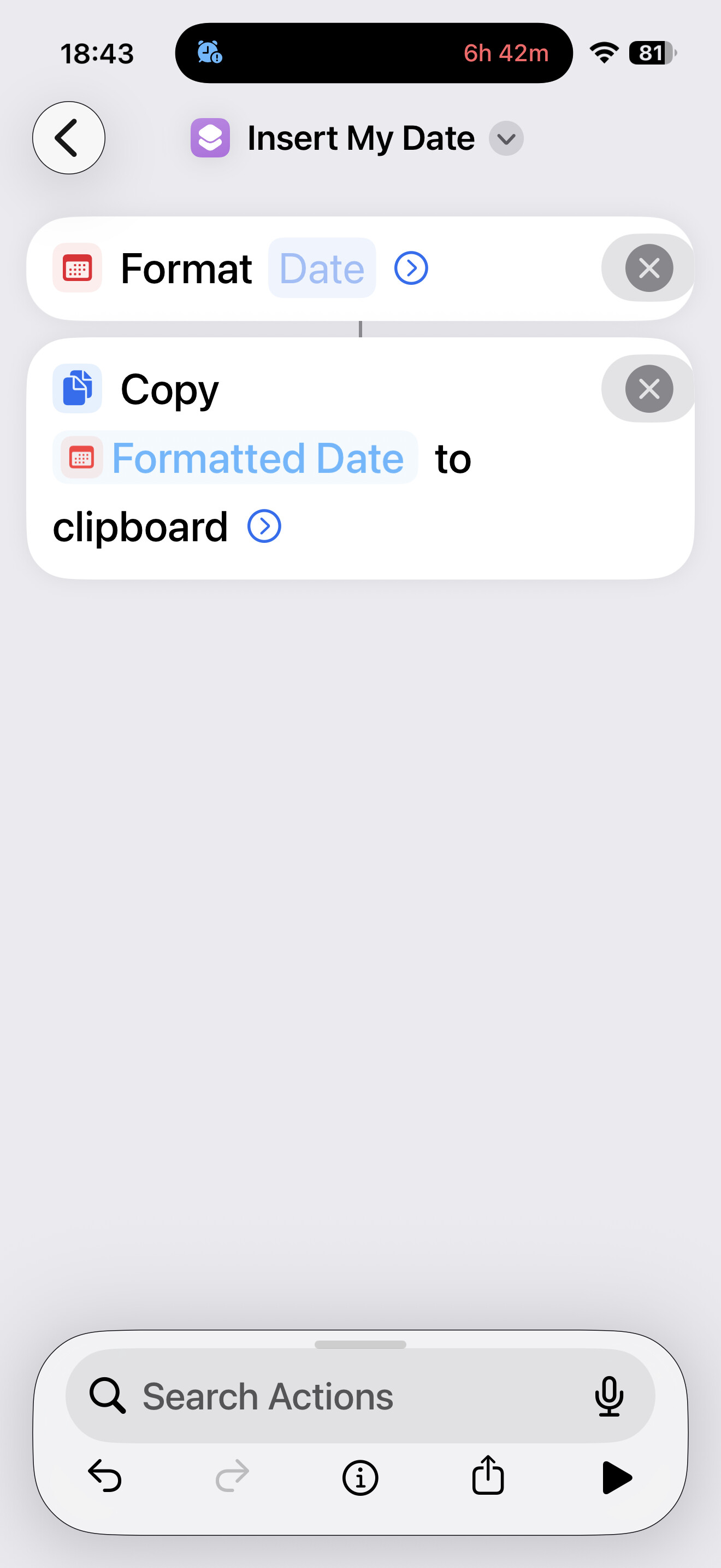

Using voice control and shortcuts Shortcuts I Ccan format the date I want it and I can Copy it to the clipboard, but I can’t get it out of the clipboard so that it inserts at the the cursor.
Apple says they do not have a Pace feature that can be triggered in a shortcut.
I had the Paste app installed, but I did not see how it could be used to actually Pace the context of the clipboard. I deleted it to see if it was getting in the way but it did not seem to be.
Any other app that works with Shortcuts, that would just go ahead and paste the contents of the clipboard.

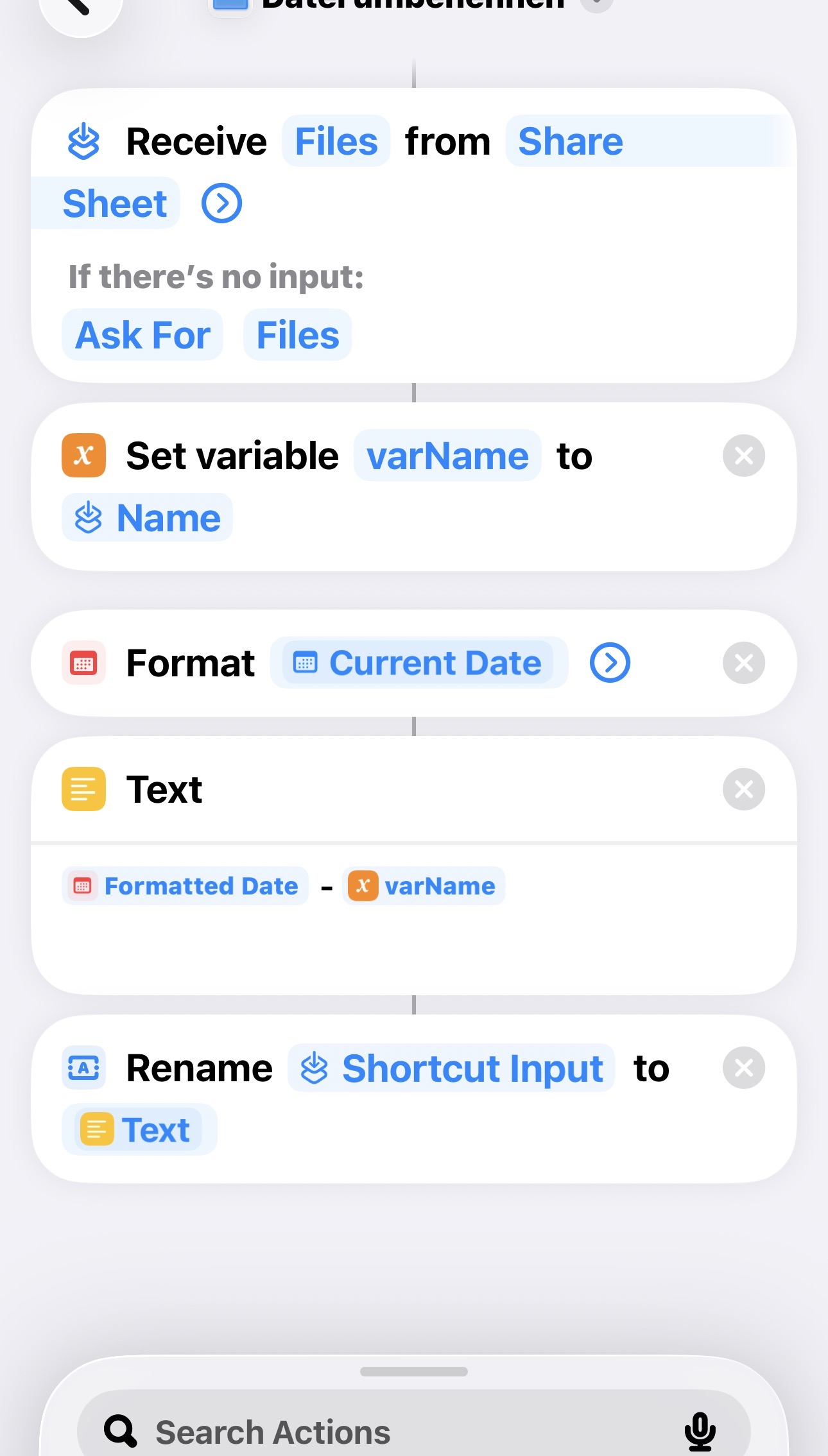

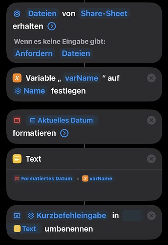

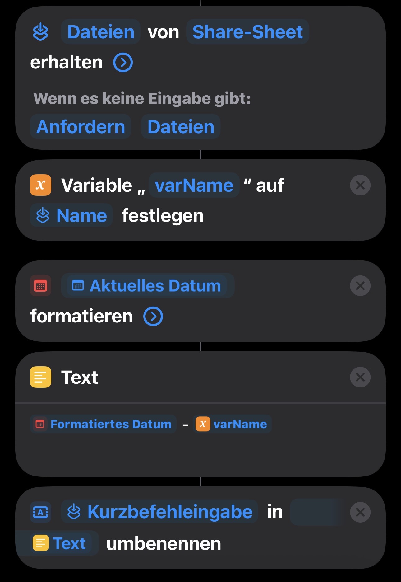

Based on your screenshot I believe your shortcut misses a setting in format date: click on „Date“ and select „current date“ or something in the selection above the keyboard. In its current form I believe it tries to rename an empty value … the „Date“ is not really a date but a placeholder?! Maybe it will then work?
Via shortcuts it’s also easy to rename the file directly, so you would not have to fiddle with the clipboard and maybe paste the desired date manually?
See my screenshot for an idea (sorry for the german UI :innocent:). It currently only takes today’s date but could be adjusted to any date or entry you want.

Sorry to resurrect the what’s the best format to put a date in debate, what I was really looking for was Help on the shortcut, format date will give me the right date in the format I want, but I can’t get it out of the shortcut to where the cursor is on the iPhone.

There is no way to automatically paste the contents of the clipboard anywhere in iOS.
You have to paste. It is an active process that has to be completed by the user himself using the GUI or cmd - v when using an external keyboard. Sandboxing at work.
“My feeling is Apple needs to include it as a new clipboard action in shortcuts as paste clipboard.” (via https://www.reddit.com/r/shortcuts/comments/17fppa7/comment/k6e7rwl/)
Again, I think they actively may have chosen not to do so.
The only other option I can think of is using a custom software keyboard like the ones that come with text expansion tools like Text Expander or Rocket Typist to trigger their expansions.

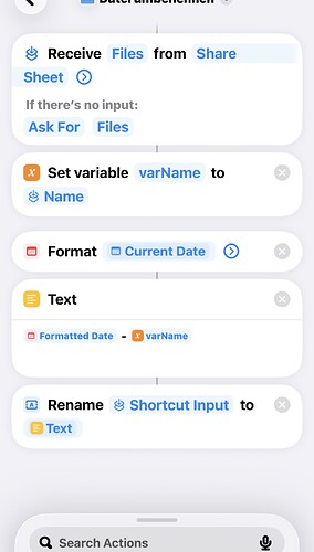

I quickly set my iPhone to English, hope that screenshot makes it easier :blush:?
In my example you don’t need to position the cursor anywhere as it renames the file directly. The variable „varName“ is used to hold the original filename, the „text“ action then combines the adjusted date format with the original name - basically putting the date at the front and the last action replaces the old filename with that new filename.
Hope it brings you in the right direction.
