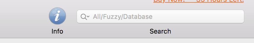

Thanks @BradG! I’ve always used the search bar in the toolbar and I didn’t know this other search was even available!
Ok, I see. Thanks!
Seems like a strange decision to me. At least that it’s not possible to also include a group in the tag view.

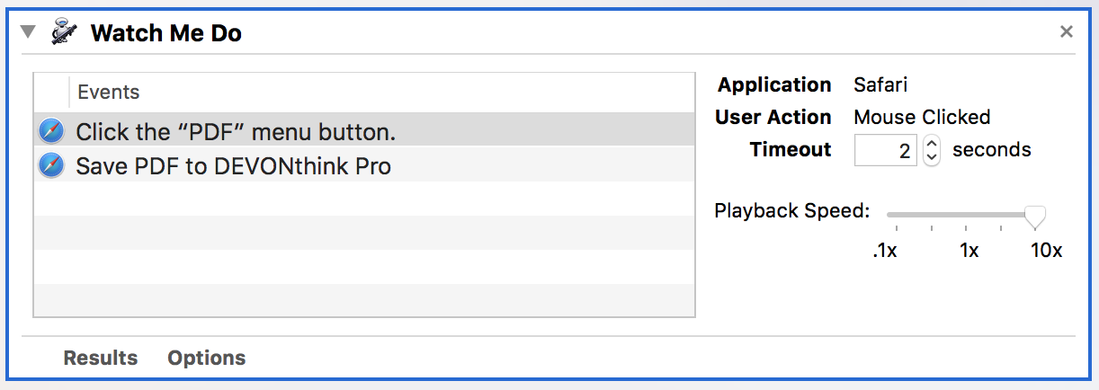

I did something nerdy today and I’m kinda proud of myself since I’ve never used either of these apps before. I prefer PDFs in DevonThink when possible. Of course, I don’t want all the ads and junk in my DevonThink, so I’ve gotten in the habit of launching reader view in Safari, selecting Print, and then “Save PDF to DevonThink.” I’m happy with the workflow, but I’m not happy with all the clicking around. Sooooo today, I made a button on my MacBook Pro TouchBar to do all that clicking for me!!!
First, in Automator, you will need the following. I couldn’t figure out how to do it any other way than “watch me do,” but it’s working. Here is where I select the option in the print dialogue box to print to devonthink. We’ll need this in the next step once we get to BTT.

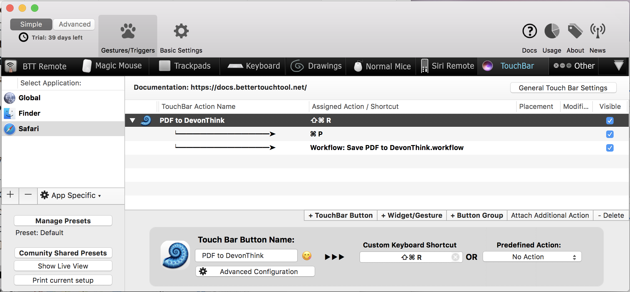

In BTT, I did the following:
My Touch Bar currently looks like this. (The PDF to DevonThink is a Safari Specific button in Better Touch Tool):
Feel free to recreate/deconstruct/tell me how to improve this!

Hmmm - did not know about the “Watch me do” option inside Automator!

I think there is a way in settings to set a hotkey combo to print PDF straight to DevonThink. That would simplify this workflow and speed it up. But then you wouldn’t know about “watch me do!”
I think there is a MacSparkyism, mapping the shortcut Cmd+P to print to pdf, so in an app, you press Cmd+P twice (first time to Print, second to Save to PDF), and it’s saved to a pdf. You could do the same with DT, Cmd+P to Print, Cmd+P to print to DEVONthink.
n.b. On my iPad, so some of the wording isn’t correct, but should be conceptually sound.
You read my mind! I was just reading @MacSparky’s post about this. It’s brilliant. I got it working just as he directed. I also added a Command D shortcut for saving the PDF to DevonThink. My workflow just got a lot simpler!!! Convert to Reader View Shift + Option + R then Command P then Command D … Now all with one button! Yay!
