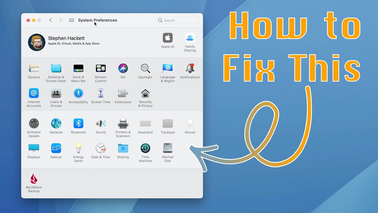

You don’t have to take what Apple gives you!
For example, here’s what I see when I open System Preferences:
Boom. Done. Nice and neat, alphabetized, and only showing the ones that I use most often.

Customize Your System Preferences
Do you use a mouse and a trackpad? No? Then why do you have System Preference panes for both visible. Do you have a CD/DVD player attached? No? Is the System Preference pane for CDs/DVDs visible? Should it be?
Actually, let’s think about it from the other direction: Which System Preference panes do you use most often? For me, it’s these:
but here’s all of them:
All the ones that do not have a blue checkmark next to them are ones that I know that I don’t see all that often. I don’t use Screen Time, or Siri, or Sidecar… so I never need to see them. I don’t use a mouse, so I don’t need to see that one. Why would I want to see icons for those?
I use Touch ID all the time, and Wallet/Apple Pay, but I don’t go into the System Preferences for them very often. So why do I need to see them all of the time?
The obvious answer is “I don’t.”
Go View » Customize… and uncheck all of the ones that you don’t use at least once a week.
