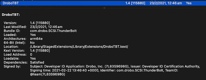

First let’s see if the kernel extension is available and running.
  • Open System Information
  • Navigate to Software/Extensions and type ā€œDroboā€ to skip forward
  • Hopefully it looks like this
If it does, I’m honestly not sure what to suggest. I had intermitted issues with mounting when I gave up last year sometime, so it might come good with some good old fiddling.
If it doesn’t, this might be an issue with the kernel extension just not working with 15.4. You can try to run these commands to see if they help:

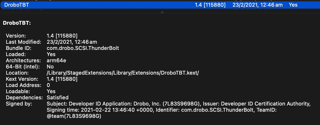

I’m also upgrading my MacStudio now to 15.4, it has the Drobo software still installed and the Kernel Extension running. I’ll see if that is still the case after the install and report back.
After upgrade to 15.4, the Kernel Extension appears to be still available and loading.

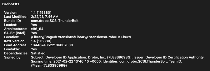

It is running - here is mine:
Yes - it appears to be running. Here is my returned result from Terminal:

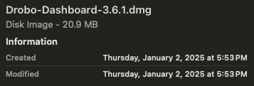

I may try this. I found my saved copy of the installer:
