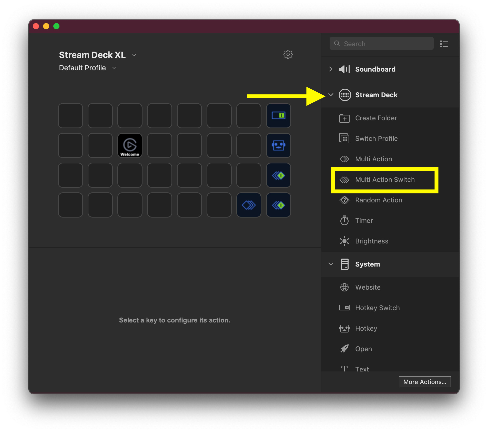

Can anyone point me to a simple explanation as to how to implement a single on/off button for lights on Stream Deck. I have managed to get a button to switch on my light via IFTTT and Webhooks. Trouble is it only goes on!
I know that it is possible to have another off button but I wanted to have a single button that is lit/unlit for on/off.
I have tried to follow the clever stuff that @tjluoma has in the post above about calendar meetings and buttons changing but that is beyond me at the moment. Thanks all.
Are they Hue bulbs? If so there are tools built-in to the Stream Deck software to connect it to a Hue bridge and see all of the rooms and scenes.
No, it is a standard lamp with a TP-LINK smart switch attached to it. One of their Kasa range of switches.
I have managed to get it all working so I can trigger the light on via Stream Deck, using IFTTT but want the finesse of the StreamDeck icon being ‘on’ and ‘off’!
I only have Hue bulbs and I do not use IFTTT so I’m afraid I cannot give you any further help. Sorry about that.
On the right-hand side in the Stream Deck app, look for "the “Stream Deck” header/section, and then “Multi-Action Switch”
I think that might be what you’re looking for…
Thanks, yes, I think that it is. I assume that I need to create the two IFTTT actions for light on and light off and then apply them to the two switch states?
Yay! Sorted it. Black icon for light off and red for light on. Works a treat
Thank you @tjluoma for your help.
