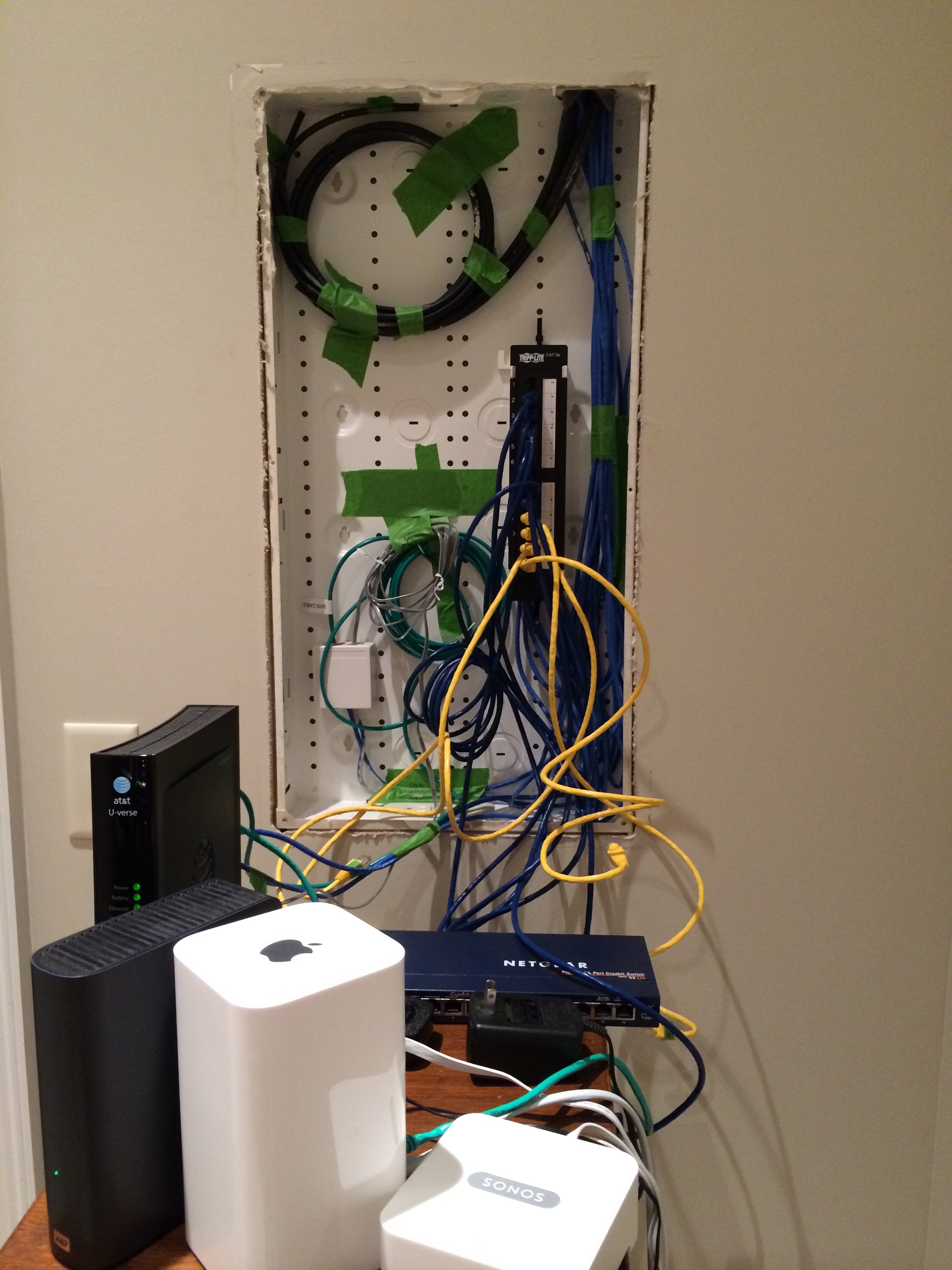

This is a picture of the inside of the panel in the utility room. This was taken in 2014 when we moved in and was working of setting it up. The blue Cat5 cables were in the panel without jacks. The Cat5 cables were dropped into 5 rooms (2 outlets in each). I added the patch panel and connected the Cat5 to it. However, when I went to plug into the ethernet jack in my office, I realized that the electricians terminated the Cat5 in each outlet to phone jacks (RJ11) instead of ethernet jacks (RJ45). The contractor said that the electricians didn’t have the right equipment to install ethernet jacks. Oh, well. Sorry, to get on tangent. Anyway, see the black coax cable? There are 2. I don’t think I need them. Can I cut them in the attic and use 1 to tape to fiberoptic cable in the attic and pull through to the box? Can this be done without damaging the fiberoptic cable?

Coming to the house from the outside are 2 ethernet cables and 2 coax cables. The ethernet cables are currently connected to the ATT box on the outside.

I was spent some time in the attic last night and was able to confirm that there is no access to the panel. However there is a small area (about 4 inches) of the wall header that is accessible. I’m fairly certain that this would put the drop into the wall cavity just to the right of the panel. This should solve my problem. The installer would need a right angle off-set drill adapter.

I finally got fiberoptic internet installed to my home. Despite my admonition that the fiberoptic cable couldn’t be dropped into the panel in my utility room, the tech was able to do so. So this was an unexpected good outcome.
I am getting 940 down/up to my ethernet wired Mac mini in my office and to the Apple TVs. I get 350-400 on my office MacBook Air via wifi and 500 when I move it to the living room or dining room. My wife gets 500-600 by wifi on her office iMac. So, all is good.
