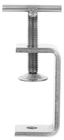

Regarding braces and such, you might be able to find a clamp that’s unobtrusive enough that it’s not horrible to look at on top of the desk (or put something over it?). Then you could clamp a wooden beam to the underside of the desk. That would give you a solid attachment for the beam, which you could screw the board to.

I started down that route and had all kinds of very cool and practical suggestions - then I thought to look at a pic of the desk. It looks like the legs are too far from the back of the desktop if the pegboard is to be above the surface and possibly too close to the front to allow enough legroom for an under-desk mount. That’s what led me to braces fixed to the desktop. Your clamp suggestion has the major benefit that it leaves the desktop free of holes, which may be a benefit in future.
