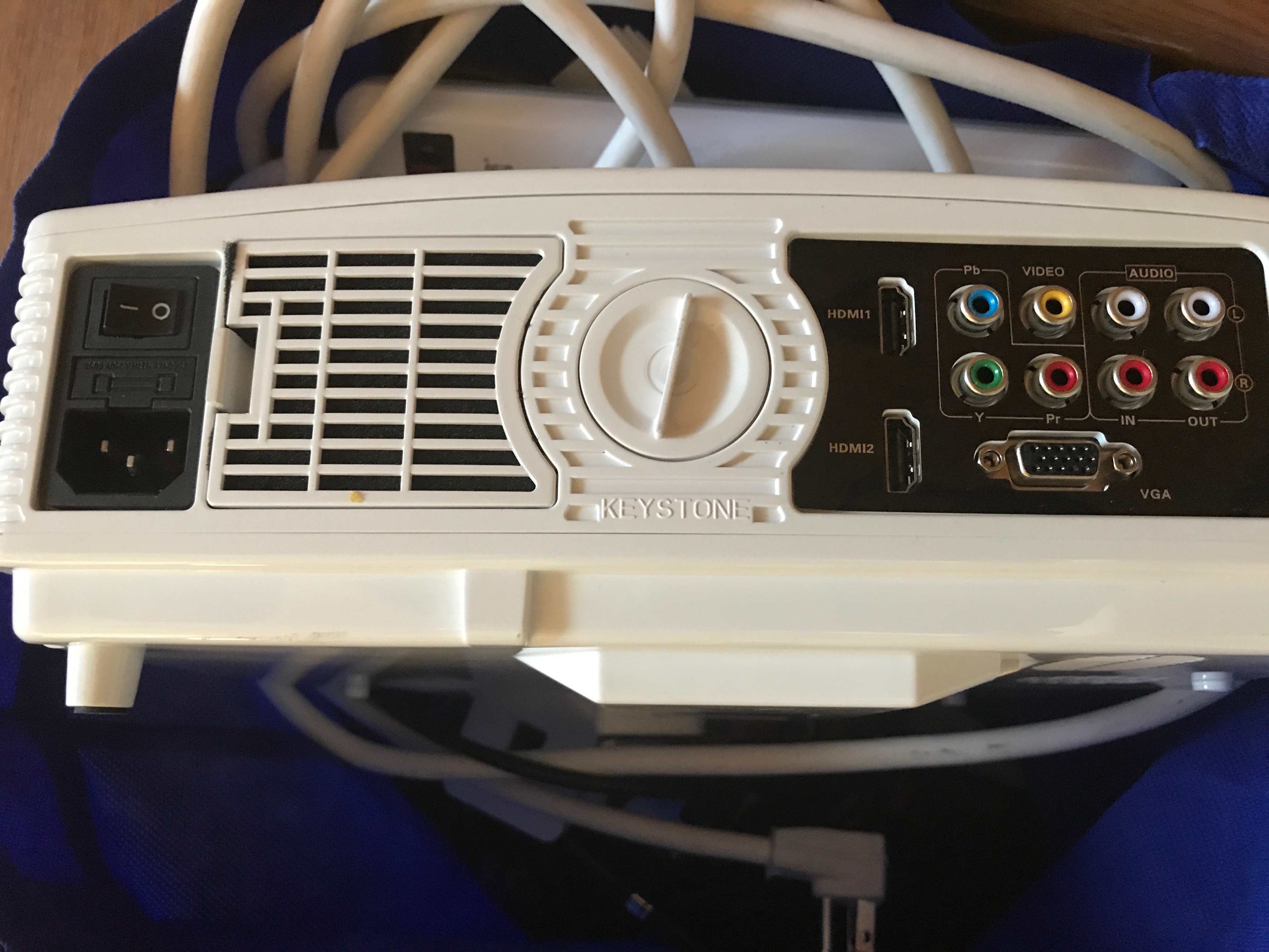

Thank you everyone for your comments! I will study them carefully when I get home from work. To answer some immediate questions. I am speaking to a Rotary club of about 20 members. We are in a private room in a restaurant, but I believe it will be in the basement and I don’t think I will have wifi available. (Or sketchy wifi at best). I was hoping to use HDMI, but after reading a few comments here, it sounds like that might not be the best option. Also, I was going to play a video clip, but (glad I asked) they don’t have speakers! I have a small Bluetooth speaker that I could take, it will also plug in via headphone jack if I could figure that out. (Maybe the headphone port on my Mac? Or bluetooth to my Mac?) I asked for a pic of the projector and here it is. Ultimately, I’ll need a toolbox like Dave’s, but this is my first (of many to come) presentation in decades and I don’t want to break the bank. Another question, how long should my cables be? I have no idea how the room is set up.55362613180__39D35D30-E3B5-41A4-9B73-9D03C5AD8264
