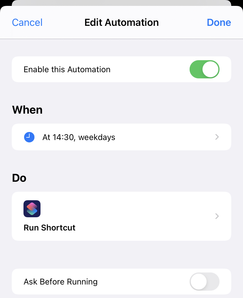

Has anyone got this to work consistently yet? I get the following box and I have to run it manually:
Not sure if there’s something in my shortcut - I doubt it as I’ve made the device vibrate and send an alert as the very first thing.
The time of day part simply runs a shortcut

There’s probably an action in the Shortcut that Apple wants a user interaction for; you could try stripping down the automation to find out.

Anyone that’s on iOS 14.0.1 that have automations that aren’t going off, try deleting and rebuilding those automations

I’m on 14.0, and my time of day shortcuts are running fine. I still get an alert when they run, but I do not have to tap to continue. they are continuing to run without my interacting.

I just created an automation to run a Shortcut to vibrate my device as a test and it worked.
I then changed the above Shortcut to vibrate the device, and then run another Shortcut to turn my torch on, and this also worked, so it seems rebuilding the Shortcut might work.
