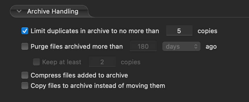

Thanks for the suggestion @WayneG. What I most like about Time Machine is the ability to browse history by date to access previous versions of files and deleted files. It looks like ChronoSync’s solution to this is their Archive feature. Is that right? Do you experience with how using ChronoSync for this would differ from Time Machine? Thanks!
Correct. To restore a file you can use the Archive panel in Chronosync or browse/search the archive folder the same as any other. You can customize what is archived, how many versions to keep, and for how long.
