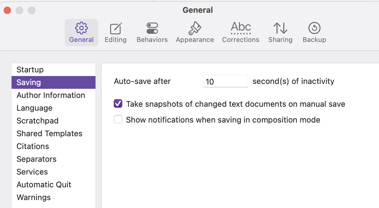

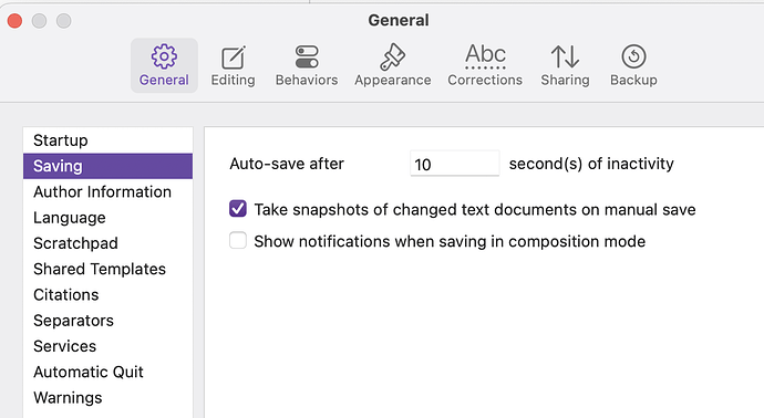

Scrivener can take automatic snapshots of changed text.

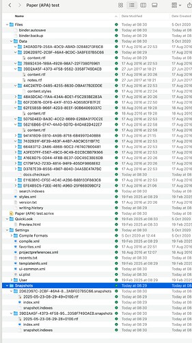

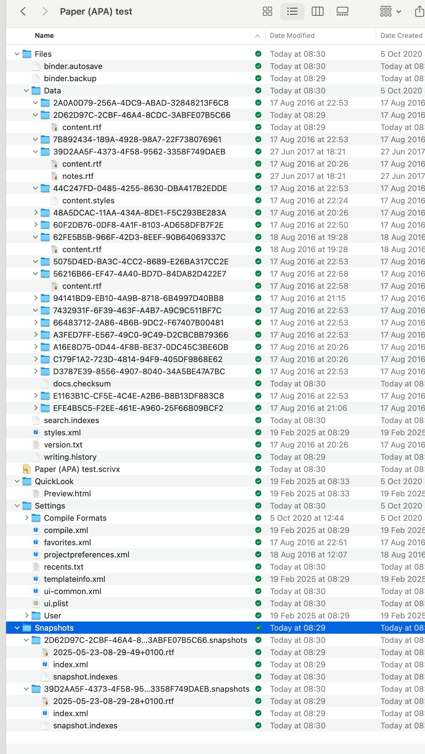

The reason for this behaviour is that under the hood the content of each folder and file in the Binder is in a separate Finder folder (with an impenetrable name) and the snapshots for each document are stored in a separate Snapshots subfolders with the same long name.
The order of files and folders is stored in the Project name.scrivx file (which is basically the project’s index), and that isn’t backed up in the snapshot process.
On the Mac we see the main project folder as a single Scrivener project, but it’s actually just a normal folder that MacOS treats specially (a ā€˜package’). You can see this if you right-click on a project in the Finder and Show Package Contents:
The content of each document in the Binder is held in the Files > Data subfolders with incomprehensibly long names… Any snapshots are in the Snapshots folder.

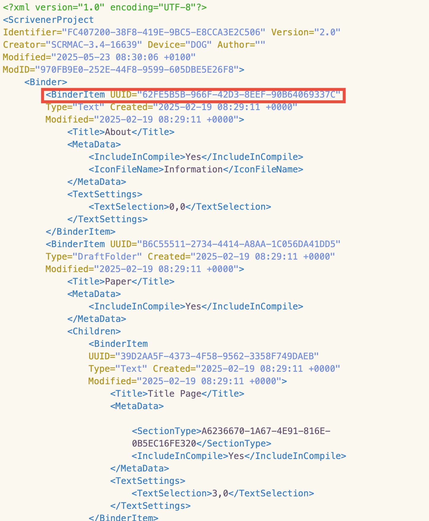

This is all held together in the Paper (APA) test.scrivx test file, which is basically an XML index file representing the current order of the Binder, as well as each document’s metadata.
So, to know which of the Files subfolders with the long names corresponds to any particular Binder item, you have to search for the title in the scrivx file to find the <Title> line, then look at the <BinderItem UUID="very long number" line above it.
