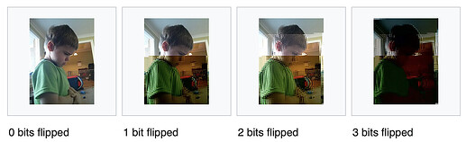

Guys, in simple words,
  • what’s your way to make sure your files won’t be lost if your SSD suddenly die,
  • and what’s your way to make sure they won’t be silently corrupted because of data degradation?
https://en.wikipedia.org/wiki/Data_degradation
For example, I can buy a NAS, but how will that help me avoid the following scenario:
  1. Today is 11 Nov 2024. Everything is fine with my Mac’s SSD (I hope…). I make a backup from Mac to NAS.
  2. Time goes on…
  3. Now “today” is 1 Jun 2025. I make a new backup from Mac to NAS. But what I wasn’t aware of is that the same file on Mac has been corrupted because of degradation since yet, and now the corrupted version from Mac’s SSD has overwritten the “OK” version on a NAS. The “OK” version is lost and now I have two copies of a corrupted version.
